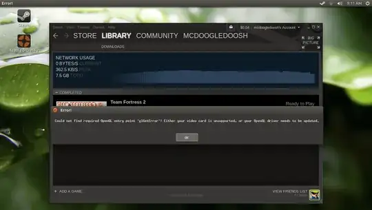

I recently upgraded to 14.04, then I installed steam, and TF2. I get this error message:
Could not find required OpenGL entry point 'glGetError'! Either your video card is unsupported, or your OpenGL driver needs to be updated.
"Could not find required OpenGL entry point "glGetError"! Either your video card is unsupported, or your OpenGL driver needs to be updated.
Anyway, I know I need to update my OpenGL Driver, my question is how do I do it?

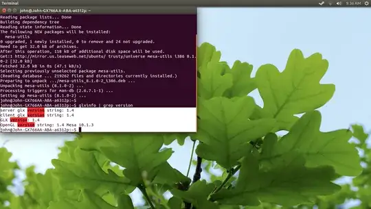

EDIT: I installed mesa and entered glxinfo | grep version into Terminal and got this,

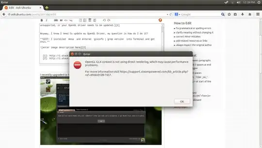

enter image description here New Edit: After looking into the first answer, I did all of the steps, and restarted my computer, when I launched steam on startup, I got the following error,
