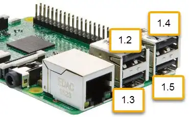

You can list the USB serial devices like this
ls -l /sys/bus/usb-serial/devices
total 0
lrwxrwxrwx 1 root root 0 Oct  9 09:10 ttyUSB0 -> ../../../devices/platform/soc/3f980000.usb/usb1/1-1/1-1.3/1-1.3:1.0/ttyUSB0
lrwxrwxrwx 1 root root 0 Oct  9 09:10 ttyUSB1 -> ../../../devices/platform/soc/3f980000.usb/usb1/1-1/1-1.5/1-1.5:1.0/ttyUSB1
The two lines are ending with
1-1.3:1.0/ttyUSB0
1-1.5:1.0/ttyUSB1
This is on a Raspberry Pi. I will now leave the device ttyUSB1 connected, and pull out the adapter ttyUSB0 and plug it into another port, then another, and then back to the initial port
# original setup
['1-1.3:1.0', 'ttyUSB0'] --
['1-1.5:1.0', 'ttyUSB1']
# move it to port above 1.3
['1-1.2:1.0', 'ttyUSB2'] --
# move it to port above 1.5
['1-1.4:1.0', 'ttyUSB2'] --
# move it back to the original port
I don't know why 1-1.3:1.0 isn't getting cleaned up upon disconnection, but I can live with that, since I rarely change the adapters from one USB port to another one.
