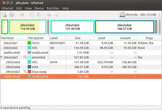

EDIT 3: Here is the pic from gparted - http://tinypic.com/view.php?pic=n3k85d&s=8#.UwqTGYXSvIU

We discussed about the problem in this chat room.I thought that something weired happened during the installation process.So i asked him to reinstall Ubuntu on the same /dev/sda6partition.He does it and it works for him.
Steps:
  • Boot Ubuntu live disk and choose Install Ubuntu option on startup.
  • After that choose "something else" option,so that you can be able to install Ubuntu on a partition where we wants.
  • Choose /dev/sda6 and format it to ext4 filesystem.
  • Then install Ubuntu on the same formatted partition.
  • After the installation completed, remove your installation medium and boot from your HDD.
  • Grub will appears and prompts you to choose the Os's on startup.
