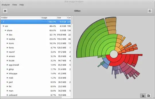

I am a big fan of baobab to figure out where the big files are hidden. To install:
sudo apt-get install baobab
