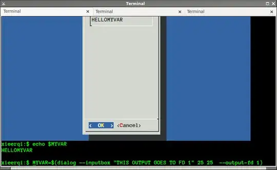

Using dialog's own tools: --output-fd flag
If you read man page for dialog, there is option --output-fd, which allows you to explicitly set where the output goes (STDOUT 1 , STDERR 2), instead of by default going to STDERR.
Bellow you can see me running sample dialog command , with explicitly stating that output must go to file descriptor 1, which allows me to save it into MYVAR.
MYVAR=$(dialog --inputbox "THIS OUTPUT GOES TO FD 1" 25 25 --output-fd 1)

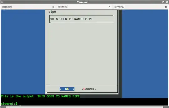

Using named pipes
Alternative approach which has a lot of hidden potential, is to use something known as named pipe.
#!/bin/bash
mkfifo /tmp/namedPipe1 # this creates named pipe, aka fifo
# to make sure the shell doesn't hang, we run redirection
# in background, because fifo waits for output to come out
dialog --inputbox "This is an input box  with named pipe" 40 40 2> /tmp/namedPipe1 &
# release contents of pipe
OUTPUT="$( cat /tmp/namedPipe1  )"
echo  "This is the output " $OUTPUT
# clean up
rm /tmp/namedPipe1
