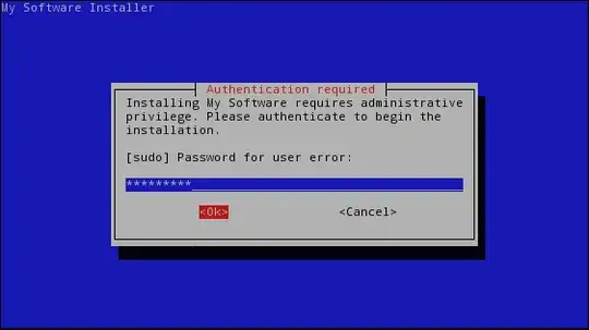

If you'd like a pretty dialog, try something like this. I ripped this straight out of something else I wrote, so it's got extra stuff you might not need or want, but it shows the general idea:
brand="My Software"
# Check that the script is running as root. If not, then prompt for the sudo
# password and re-execute this script with sudo.
if [ "$(id -nu)" != "root" ]; then
    sudo -k
    pass=$(whiptail --backtitle "$brand Installer" --title "Authentication required" --passwordbox "Installing $brand requires administrative privilege. Please authenticate to begin the installation.\n\n[sudo] Password for user $USER:" 12 50 3>&2 2>&1 1>&3-)
    exec sudo -S -p '' "$0" "$@" <<< "$pass"
    exit 1
fi
sudo dialog
This uses whiptail, which you can install if you don't already have it:
sudo apt-get install whiptail
