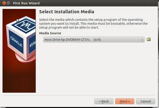

    When you boot the VM for the first time, it should ask you the details of installation media.. Select your downloaded iso file, and it should work great. If you have a cd, select your cd drive there.Virtualbox first-run wizard.
