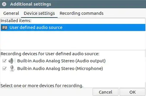

Just use this package
Select these two checkboxes and select User defined audio source from drop-down.
