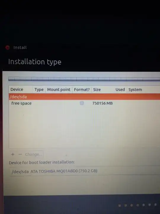

Either way, upon install - No other OS is found. Not to worry, I've been here before and created partitions. However, my next screen disturbing: enter image description here
Basically, the partition that I set aside for Ubuntu isn't found and all it recognizes is that there's a single hard drive waiting to run amok on. Help?

The solution is here
And the exact steps it took to get my partitions to be recognized again are as follows...
  1. Open a Terminal and run sudo gdisk /dev/sda
  2. It is likely that both MBR and GPT will be found and asks you which one to use - the choice is irrelavant.
  3. Type x for the next command because well, you're doing expert stuff
  4. Type z to zap the GPT data
  5. Type y to proceed destroying GPT data
  6. Type n in order to not lose MBR data
Opened GParted, no Warning message about GPT signatures and my partitions are recognized :)
Thanks all for your time and advice
