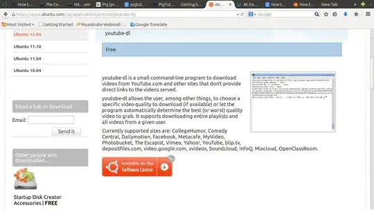

But I want to know how to select available pixel quality of youtube video(i.e 1080p, 720p, 480p, etc).
In software description they said it's possible(shown in image below), but how to do..
ss

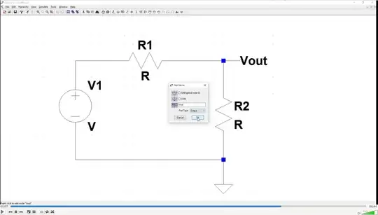

(Note: all circuit schematic images below are actually screenshots from this electrical-engineering-related video tutorial: Video One- Getting started with LTspice).

Here's some screenshots from a tutorial video I was watching showing electronic circuit diagrams in the video. Notice how the latter one is much higher quality and more legible (click on each image and compare the tiny font in a zoomed-in view):
  1. Using the lower quality -f bestvideo+bestaudio option accepted here as the right answer (OR just using the default option: youtube-dl 'https://youtu.be/FWGC9SqA3J0'):
  • enter image description here
  • Notice how fuzzy the icons are at the top, and how difficult to read are the open window and tiny words within it!
