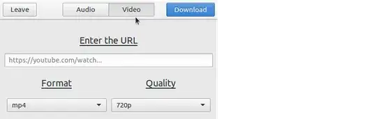

Ubuntu 14.04 and later
The youtube-dl snap package (youtube-dl) is updated automatically in all currently supported versions of Ubuntu. To install it open the terminal and type:
sudo snap install youtube-dl # start with snap run youtube-dl
Show the version of youtube-dl snap package with snap run youtube-dl --version
Gydl (Graphical Youtube-dl) is a GUI wrapper around the already existing youtube-dl program. To install Gydl in all currently supported versions of Ubuntu open the terminal and type:
sudo snap install gydl
When using Gydl, you have the option to download your YouTube video as a Video or Audio.
