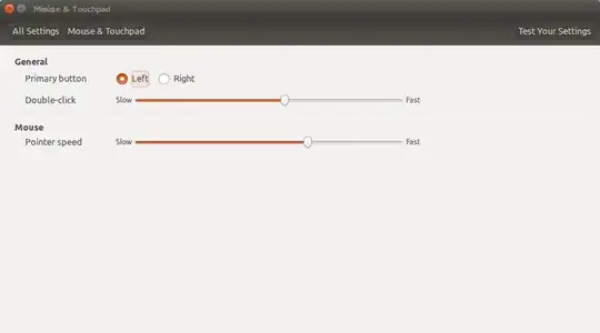

I am running Ubuntu 14.04 on my Dell Studio 1557. My synaptics touch pad is detected but the scroll functions are not working. The scroll option in the GUI for the mouse and touch pad has disappeared. I have tried reinstalling xserver-xorg-input-synaptics package but receive the following error of Package 'xorg-input-abi-20' has no installation candidate. Please advise for a solution.
Mousepad GUI

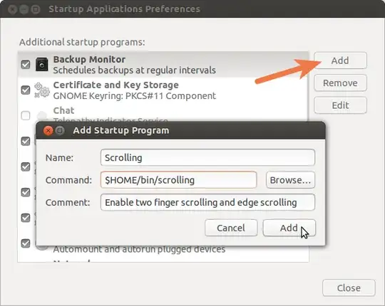

This is a possible solution for you, view the original answer here Enable Edge And Two Finger Scrolling
Quite simple create a script using gedit or a document writer
First open gedit and copy and paste the following :
#!/bin/bash
synclient VertEdgeScroll=1
synclient VertTwoFingerScroll=1
Save the file as scrolling.sh in your ~/bin directory
change the permissions to be able to run it as program open terminal CTRL + ALT + T run this command:
chmod +x ~/bin/scrolling
search for Startup Applications in Dash, and open it then set up scrolling to run when ubuntu starts up.
