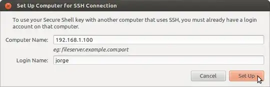

Graphical method
  1. Open ApplicationsPasswords and KeysMy Personal Keys.
  2. Select your key and then click RemoteConfigure Key for Secure Shell.
Set Up Computer for SSH Connection
