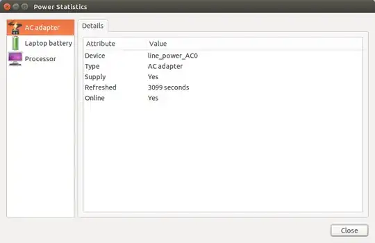

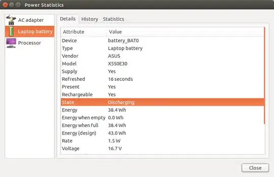

I have a fully up to date Ubuntu 14.04 on my Asus X550DP laptop. My problem is that the battery is always discharging. When I plug the AC adapter in, it charges battery up to around 96% and stops charging there, but the power management tool says that my battery is in use and is discharging. What is the problem?
Edit( my AC plugged in )
Ac profile AC adapter
Battery profile Laptop Battery

Pablo Bianchi
  • 17,371
Do you still have the problem? You may try to recalibrate your battery. Just follow the steps described here under the paragraph "How to Manually Calibrate a Battery". The process itself works equal with Ubuntu.
MofaSofa
  • 324
An inaccurate gauge can lead to the fact that the the battery capacity values are are wrong. The battery may report that it still has 10% of capacity when in fact it has a much lower value, and this causes the computer to shutdown unexpectedly.The most adequate method to do a full discharge (100% to a minimum of 3%) consists of the following procedure:
Fully charge the battery to its maximum capacity (100%); Let the battery "rest" fully charged for 2 hours or more in order to cool down from the charging process. You may use the computer normally within this period; Unplug the power cord and set the computer to hibernate automatically at 5% . If you cannot select 5%, then you should use the minimum value allowed, but never below 5%;
Leave the computer discharging, non-stop, until it hibernates itself. You may use the computer normally within this period; When the computer shuts down completely, let it stay in the hibernation state for 5 hours or even more; Then plug the computer to the A/C power to perform a full charge non-stop until its maximum capacity (100%). You may use the computer normally within this period.
After the calibration process, the reported wear level is usually higher than before. This is natural, since it now reports the true current capacity that the battery has to hold charge. Lithium Ion batteries have a limit amount of discharge cycles (generally 200 to 300 cycles) and they will retain less capacity over time.
Many people tend to think "If calibrating gives higher wear level, then it's a bad thing". This is wrong, because like said, the calibration is meant to have your battery report the true capacity it can hold, and it's meant to avoid surprises like, for example, being in the middle of a presentation and suddenly the computer shuts down at 30% of charge.
SOURCE:batterycare
