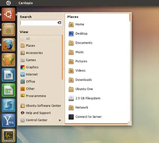

Cardapio is a nice middle-ground between the old and new interfaces:
Cardapio from Web Upd8
This screencast shows it in action. The custom launcher available from Web Upd8 makes it quite convenient to use.
It's currently only available from a PPA:
sudo add-apt-repository ppa:cardapio-team/unstable
sudo apt-get update
sudo apt-get install cardapio

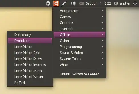

  • You can select "Classic Ubuntu" environment at the log-in screen if you prefer classic Ubuntu.
  • Optionally, you can get this classic menu indicator: OMG Ubuntu
