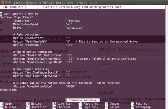

By the end of this process, you should have the new file 20-synaptics.conf inside /etc/X11/xorg.conf.d and the file should look like that:
My 20-synaptics.conf file
