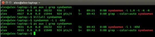

Like others here the syndaemon utility solved my issue. For me the syndaemon was already running.
After playing with it and reading some of the other answers here I determined that the cause is the -t option.
The option must have a bug because when it's specified I can still scroll and tap while typing. However, if you omit the option entirely then everything works fine; the entire touchpad is disabled as expected while typing when you don't include the -t option. I simply run the following to restart syndaemon without -t.
$ killall syndaemon
$ syndaemon -i 1 -KRd
  • -i allows you to specify how long syndaemon should wait after typing has stopped before re-enabling the touchpad. One second is what was already running and seems to be fine for me.
  • -K tells syndaemon to ignore modifier keys and modifier+key combos when monitoring keyboard input.
  • -R tells syndaemon to use the "XRecord" extension instead of polling for keyboard input. I imagine it uses this for performance reasons; the extension probably reports when typing activity stops instead of depending on syndaemon to continually poll the keyboard to see if there is input.
  • -d just tells syndaemon to run in the background when you start it, without blocking your terminal input. If you don't include this option then syndaemon will stop when you close your terminal.
So in the end it's the -t option that is the culprit here. Just get syndaemon running without it and all is well.

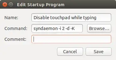

Option 2: how to fix the Touchpad not disabling while typing
  1. Uncheck “Disable while typing” in the Touchpad settings, as shown below (yes, this is necessary even though it seems counter-intuitive, or else the Touchpad will end up getting disabled after doing the following “permanent” steps and then restarting, since the previous/bad syndaemon will be started at boot and conflict)
  2. kill the current syndaemon process (if any was started previously at boot), which controls this Touchpad feature:
    pkill syndaemon
  3. restart the syndaemon process:
    syndaemon -i 2 -d -K
    ...where: 2 is the amount of delay time, in seconds, you want it to wait after you stop typing and before it activates the touchpad again; note that any time value less than 1.5~2 sec (more like anything <2 sec actually) is glitchy/buggy, and doesn't seem to keep the touchpad fully disabled while typing
  4. To make this fix permanent: run the “Startup Applications” app from the search bar → click “Add” → and type the following command into the “Command” section: syndaemon -i 2 -d -K. Name and Comment can be anything. Click “Add” when done, then close it. Here's what it looks like:
