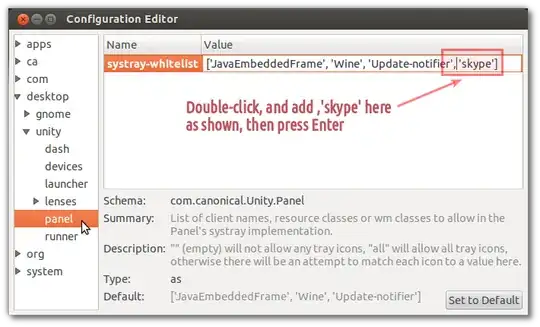

2. You may also need to whitelist the indicator
We don't know why, but for some systems this additional step is required before the indicator will show (thanks to Bruno Pereira!)
Steps:
  1. Install the package dconf-toolsInstall dconf-tools (click on the link), or from the terminal with sudo apt-get install dconf-tools
  2. Open dconf editor from the Dash (or dconf-editor from terminal):
  3. On the left sidebar, use the triangles to navigate to desktop > unity > panel. On Ubuntu 12.10 you instead need to navigate to com > canonical > unity > panel. Double-click on the orange [JavaEmbedded...] part on the right, and add ,'skype' to allow the Skype indicator to show, as below:
  4. Press Enter, close dconf editor, logout and login -- your indicator should now be back!

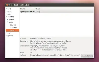

Then press alt+f2 and enter dconf-editor to see a program like this:
dconf-editor
Navigate to desktop-->unity-->panel and add the apps that you like to whitelist to the end of the list (in your case you must add 'Skype') separate by comas. You can instead write all to whitelist all apps to use the notification area.
