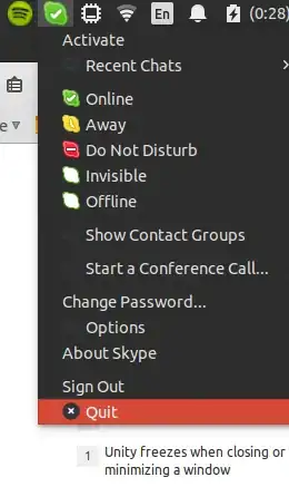

Once you close the window, as you've seen, the program minimizes to the top bar. From there, you can quit them both.
Spotify:
Skype:
If you have no Skype icon, run this command:
sudo apt-get install sni-qt:i386
and then restart. It should enable the Skype icon.
