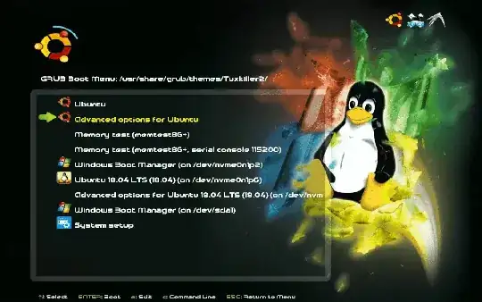

Running Virtualbox 5.1.34 under Ubuntu 16.04 I was disappointed all attempts at 1920x1080 or 1600x900 resulted in 640x480. Like many I discovered 1024x768 was the highest allowed and anything over would downgrade to 640x480.
Running vbeinfo at the grub prompt I discovered 1600x1200x32 was supported even though my monitor was 1900x1080. So I changed /etc/default/grub to:
GRUB_GFXMODE="1600x1200x32"
And wow what a difference!
Part of the top and bottom is clipped / truncated but it's not a big deal and it's nice to see the window larger and legible:
I had to compress the .GIF to make it fit here, it's nicer live. I have two monitors (one above the other) so Virtual desktop size is 3840x1080
