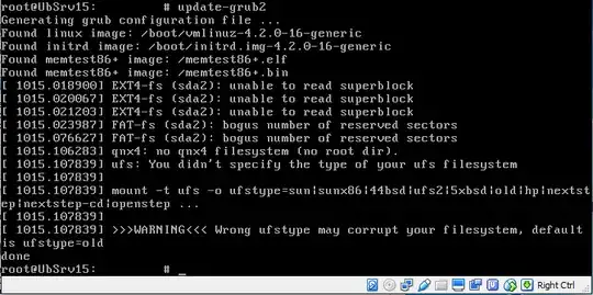

I tried editing the GRUB_GFXMODE line according to the vbeinfo's available resolutions. After running update-grub and update-grub2 I got the following output: output from running update-grub command
Ideas?

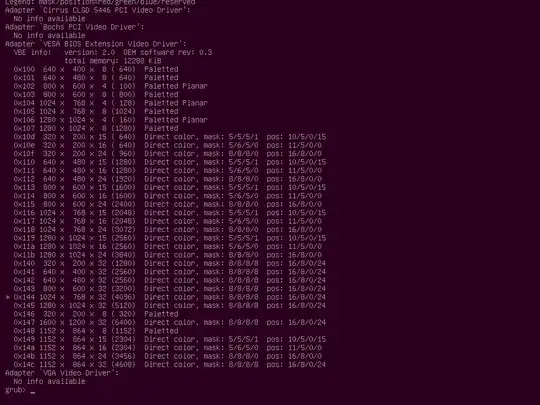

  1. Boot the Ubuntu VirtualBox and press Shift to get Grub2 menu.
  2. Press c to bring Grub console
  3. Run vbeinfo to get supported modes
    grub2 vbeinfo - supported vesa BIOS modes
  4. Choose one and modify /etc/default/grub, example (Uncomment the line)
    GRUB_GFXMODE=1024x768x32
  5. Update boot list
    sudo update-grub
