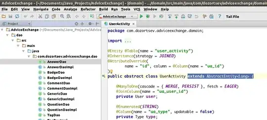

I installed IntelliJ IDEA 13.1 and Oracle JDK 1.8 on Ubuntu 14.04 x64 but when I launch IntelliJ IDEA the font is not ideal.
How I can change the font?
screenshot

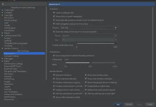

Short answer that worked for me:
1) Go to File->Settings->Appearance & Behavior->Appearance.
2) Under anti-aliasing change both IDE and Editor options to "Greyscale".
