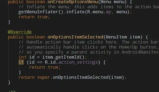

Here are some screenshots Ubuntu Mono 16 :Ubuntu Mono 16

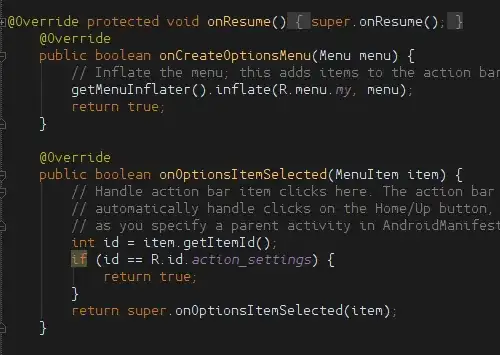

Ubuntu Mono 20 Ubuntu Mono 16

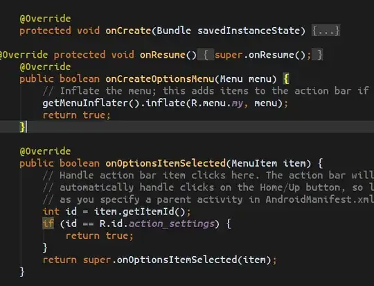

Source Pro 16 (I think comes with Studio) Source Pro 16
Ubuntu Mono 12 in Eclipse (ideal for me) Ubuntu Mono 12 in Eclipse
I have uploaded the images to imgur as this site is compressing the images, and the quality is affected.

The problem is not anti-aliasing - all of your examples show the text is anti-aliased fine.
The difference is in an aspect of font rendering called "hinting" - the top Ubuntu Mono example shows a strong hinting, whereas the bottom Ubuntu Mono example shows a smoother hinting. Hinting deforms the letter shapes to better align to the pixel grid and give a more crisp appearance.
Whether you like one or the other is a matter of personal preference. The top one is certainly very clear to read but at the expense of deforming the letter shapes.
The Java environment will be using its own font renderer rather than your global settings, hence the difference.
