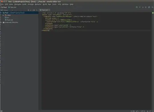

I've recently installed IntelliJ on my Ubuntu system and realized that the font I want to normally use Monaco doesn't render properly in IntelliJ. So, the problem was slightly fixed from this post however the editor would still not render properly with Monaco;
This is currently the state of my IDE:

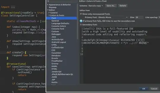

More info and screenshots of better fonts: http://urshulyak.com/page/show/2 Result: enter image description here
