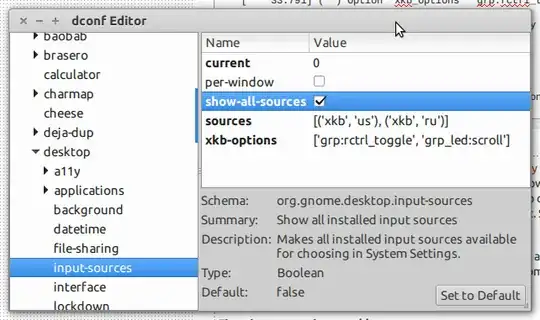

Third, gconf
I have xkb-options and sources set in org.gnome.desktop.input-sources, but Gnome still sets xkb to single English layout:

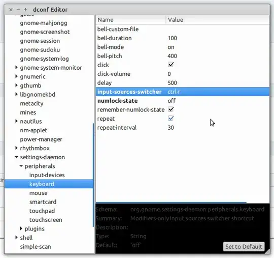

Fourth, another option in gconf
Setting org.gnome.settings-daemon.peripherals.keyboard also does not work for me. Nothing changes.
