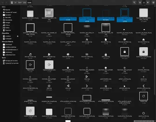

There is no easy way to do it, since it's hard coded. But a workaround would be editing the images that form the "tile" as you call it and change them for transparent (empty) images.
You can find them in:
/usr/share/unity/icons/
There you'll see a bunch of images for when the icon is normal, pressed, highlighted, etc. Edit them with gimp, for example, and replace the originals. Of course, make backups first.
