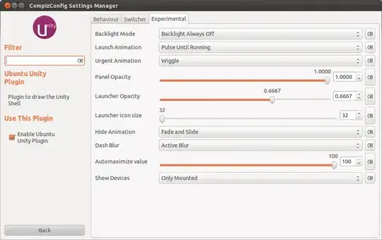

It is possible, and rather simple.
  1. Install compizconfig-settings-manager:
    sudo apt-get install compizconfig-settings-manager
  2. Then run about:config in the run dialogue in Unity: press Alt+F2 and enter about:config.
  3. CCSM will pop up with the Unity plug-in open. Navigate to the experimental tab:
    ccsm. it is open.
  4. Now change the Backlight Mode to "Backlight Always Off".
  5. Problem solved.
In light of your comment, the box never 100% goes away (by design).

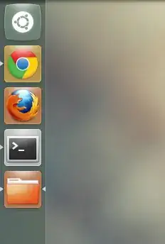

I scripted the removal of the boxes around the applications and the one around the Ubuntu button (for 12.04):
cd /usr/share/unity/5
wget -O transparent54.png "https://i.sstatic.net/MiFpK.png"
wget -O transparent62.png "https://i.sstatic.net/0NvP0.png"
for name in squircle_shine squircle_edge squircle_base squircle_base_selected launcher_icon_back launcher_icon_edge launcher_icon_shine
do
    sudo mv ${name}_54.png ${name}_54.ori.png \
done
for name in squircle_shadow launcher_icon_glow launcher_icon_shadow
do
    sudo mv ${name}_62.png ${name}_62.ori.png \
done

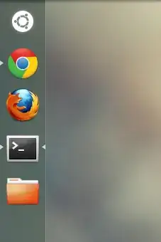

Then to restart Unity, press Alt+F2 and run setsid unity. The result looks much cleaner to me.
Before:

After:
without boxes
