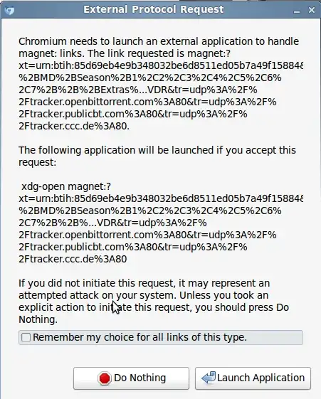

This was supposed to be a comment, but I needed to upload a pic, so here it goes:
  • In my setup, both FireFox 3.6 and Chromium 11.0 opened Deluge
  • Chromium asked for a confirmation that gives us a hint of whats going on:
This shows that Chromium does NOT launch Deluge directly... it relies on xdg-open for that. Meaning all that must be researched (and fixed) is the OS, not Chromium. Nothing to fix or change in the browser.
This is not an answer, but it will focus your efforts in the right place... what you must fix have nothing to do with the Browser, but the OS.
