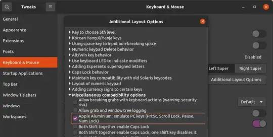

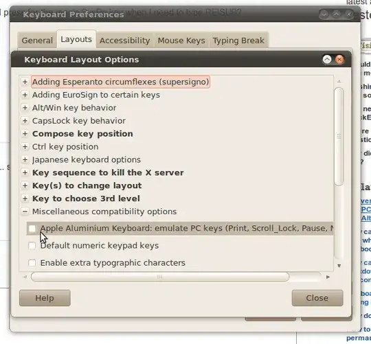

I don't have an aluminum keyboard on hand to test this, but:
On GNOME Shell: GNOME Tweaks > Keyboard and Mouse > Additional Layout Options…
screenshot
On older versions: System > Preferences > Keyboard Preferences > Keyboard Layout Options > Miscellaneous compatibility options > Apple aluminum…
screenshot
