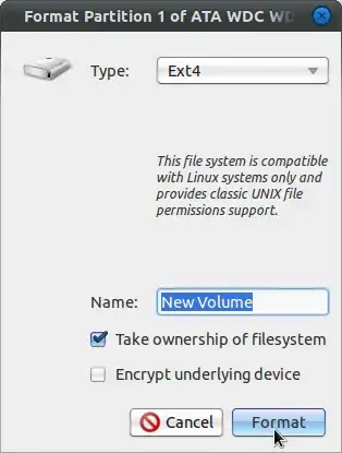

Open the disk utility and find your windows partition format it to ext4 partition enter image description here
Then open the the terminal and type
sudo update-grub
