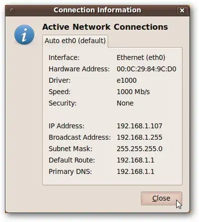

In case, the ifconfig command didn't display the IP address, there is a very simple and easy way to find out the IP address of the Ubuntu machine through the GUI. Follow the steps below:
Click the network icon in the notification area and click Connection Information. Network icon options
This brings up a window which has a some information, including the IP address. IP address information
