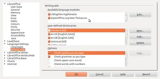

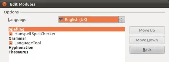

I have been trying to use English-UK thesaurus in LibreOffice but so far cannot get it to work. I have installed mythes-en-us as only it was available in repos. As suggested in some forums I searched for openoffice.org thesaurus, but again US version was available. As a result I can't enable thesaurus when I choose English UK:
LibreOffice Prefs 1
LibreOffice Prefs 2

Still the result is same as shown in above screenshots.

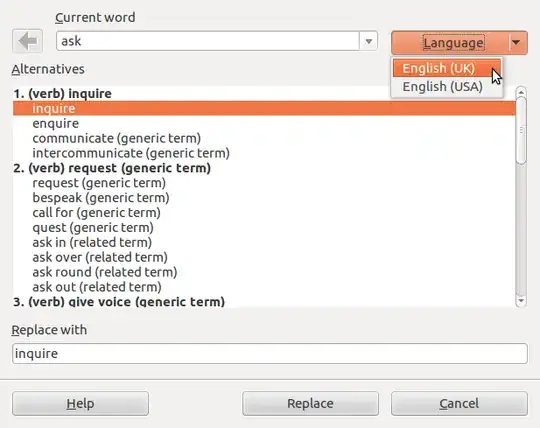

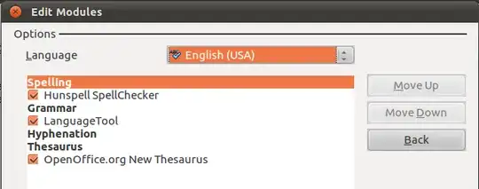

  8. Open LibreOffice Writer and go to Tools -> Options -> Language Settings -> Writing Aids.
  9. Verify the new thesaurus is selected, then from Writer test it by pressing Ctrl + F7 to bring up the thesaurus dialogue.
Language settings with new thesaurus
Functioning UK thesaurus dialogue
