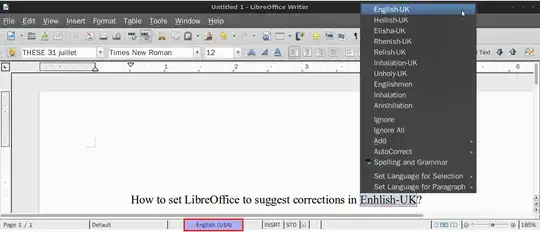

I want to be given correction suggestions while setting a text in LibreOffice to English-UK.
Now it works for English-US, French and Romanian, as these are the languages that I have installed in Language Support. I cannot seem to have a setting to differentiate US/UK English as I was able in Xubuntu.
In LibreOffice English-UK is absent. How to add it?

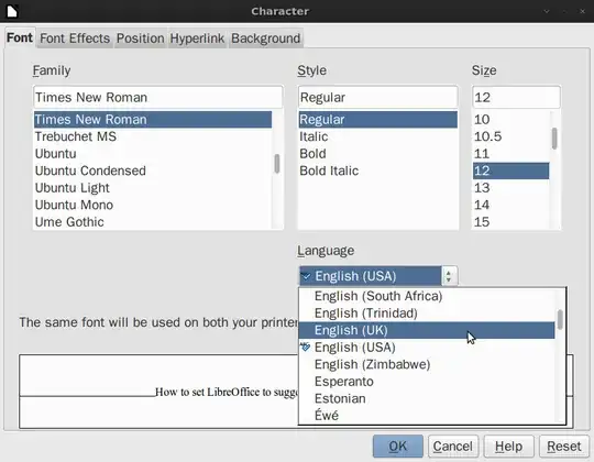

In Tools/Options/Language Settings/Languages I get to the image above, but how to make English UK present there? it lacks that 'ABC-V' sign that is present for English USA, although in Tools/Options/Language Settings/Writing Aids an 'English-uk' IS PRESENT. But that is not enough for the corrector to function for English-UK.

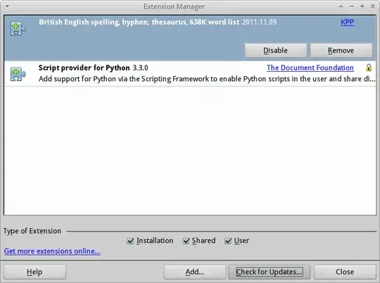

Please go to the official list of dictionaries and choose kpp-british-english-dictionary and download it to your desktop or downloads folder. Now open that downloaded file with LibreOffice itself and you will be presented with this screen:

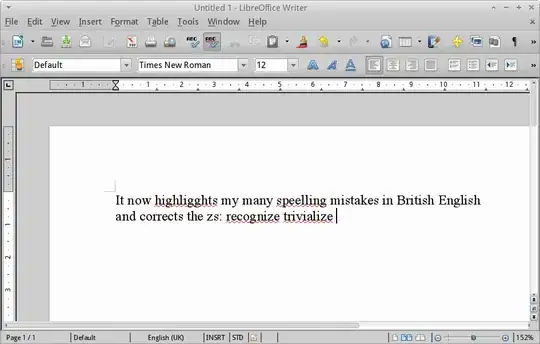

Now, make sure that it is enabled, and restart Libreoffice and open Writer, select English UK and it will auto highlight your mistakes as below, as long as the other settings are set to English UK in Tools > Options > Language Settings > Languages.
Also, it is important to make sure AutoSpellCheck is enabled.
