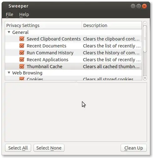

You can also use the Sweeper
Sweeper is a File System Cleaning Utility in Official Ubuntu Repository.
Install via the software center
It cleans brows history, Cookies etc.
