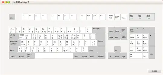

For as in "कॲकोना" (n. a name in Bengoli), the combination would be oimage1 i.e. for कॲ the combination would be koimage2, whereimage2 is the accent grave key (the lower-case of image3 key in my keyboard).
keyboardLayout
No idea for the combination (I'd use रि, if the grammar allows).
Nepali language too uses the devnagari script. Here's a snapshot of the keyboard layout:
keyboardNepali
