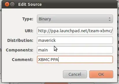

Follow this answer to add the Software Source ppa for XBMC.
Then edit the software source and change the distribution from natty to maverick as per this picture.
