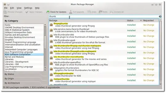

Thumbnailer
To show thumbnails the Dolphin will need the thumbnail plug in.
Video thumbnailers for the Dolphin:

Settings
To use the thumbnail you need to enable the thumbnailer from the Dolphin settings.

In a terminal run
sudo apt install ffmpegthumbs mplayerthumbs kffmpegthumbnailer
then... change in dolphin settings as says in user26687's answer... works for me kubuntu 14.04lts in laptop n4010 dell
