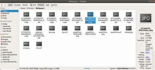

I have installed the Dolphin file manager under Ubuntu 18.04/Gnome (with apt install). It doesn't show thumbnails for any file, neither in the folder nor in the information panel (to the right). See screenshot. How can I fix it?

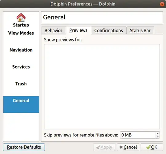

Also, in the Dolphin Preferences I noticed that under General > Previews > Show previews for: there is a blank list, which I am not allowed to edit. I believe I should have a list of file types there. See screenshot.

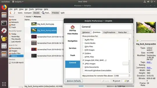

I had recently installed dolphin on Ubuntu 18.04 and could view thumbnails and also had the Show Previews pane that was missing on your system.
I looked through the appropriate history.log file in /var/log/apt to see what thumbnail-related packages were installed along with dolphin. I found two:
  • ffmpegthumbs and
  • kdegraphics-thumbnailers
Indeed, these were the only two packages with "thumb" in their names on my system:
$ apt list --installed | grep -i thumb
WARNING: apt does not have a stable CLI interface. Use with caution in scripts.
ffmpegthumbs/bionic,now 4:17.12.3-0ubuntu1 amd64 [installed,automatic]
kdegraphics-thumbnailers/bionic,now 4:17.12.3-0ubuntu1 amd64 [installed,automatic]
kio-extras, the package recommended by the second answer, along with kio-extras-data, was installed on my system, not along with dolphin but when I installed gwenview, Kubuntu's image viewer.
Anyway, this is what dolphin looks like:
Dolphin showing thumbnails and the pane to select which previews are shown
Dolphin with thumbnails and preview pane
