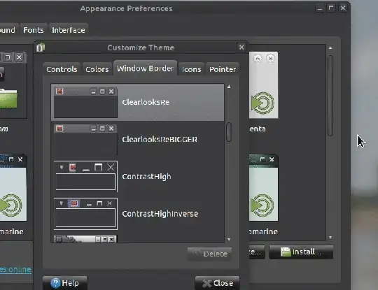

Current Solution (2019) for Ubuntu-MATE 16.x, 18.x**
(possibly more, pls add to comments)
Yes, those borders are a pain, bordering on –pun intended– masochism...
1 create copy of a theme
Well, ClearLooks is (for some reason) not really a "full theme" to pick on the Theme tab, but rather a "Border Theme" under „customize..“ on the Window Border Tab:
Well, never mind, let's create a copy (use rsync or cp as you please):
(If you are fond of another "border theme" then duplicate that one accordingly. Look it up under customize theme-> Window Border what you are currently using.)
sudo rsync -vr /usr/share/themes/ClearlooksRe/* /usr/share/themes/ClearlooksReBIGGER
2 change border width in the xml File
sudo pluma /usr/share/themes/ClearlooksReBIGGER/metacity-1/metacity-theme-1.xml
There are actually two places:
  • under <frame_geometry name="normal"...
  • under <frame_geometry name="border"...
For left, right and bottom I went for a rather generous 12px:
<distance name="left_width" value="12"/>    <!-- FRANK: was: 4 -->
<distance name="right_width" value="12"/>
<distance name="bottom_height" value="12"/>
3 pick the new Window Border theme and there you are
