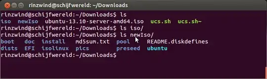

Initial setup
This will create 2 directories "iso" and "isoNew" inside your Downloads directory, mount the ISO and copy the contents from "iso" over to "isoNew" to start a new project.

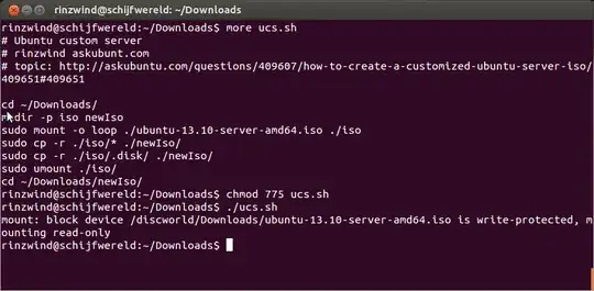

Put this in a text file, save it, make it executable and execute it:
# Ubuntu custom server
# rinzwind askubuntu.com
# topic: http://askubuntu.com/questions/409607/how-to-create-a-customized-ubuntu-server-iso/409651#409651
cd ~/Downloads/
mkdir -p iso newIso
sudo mount -o loop ./ubuntu-13.10-server-amd64.iso ./iso
sudo cp -r ./iso/* ./newIso/
sudo cp -r ./iso/.disk/ ./newIso/
sudo umount ./iso/
cd ~/Downloads/newIso/
  • It will throw 1 error message: mount: block device /discworld/Downloads/ubuntu-13.10-server-amd64.iso is write-protected, mounting read-only
Example images on how this will look like:
Executing:
Executing
Result:
Result

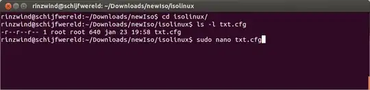

Adding a Boot Menu Option
The menu options for the installer are stored in isolinux/txt.cfg and you can create new options in-between default install and label install.
This will create a new option called "Install Custom Ubuntu server" and it will add a kickstart file (the kickstart file is used to alter options; explained below):
label myownoption
  menu label ^Install Custom Ubuntu Server
  kernel /install/vmlinuz
  append  file=/cdrom/preseed/ubuntu-custom.seed initrd=/install/initrd.gz quiet ks=cdrom:/preseed/ks-custom.cfg --
  • myownoption is just a label you can use to identify your option.
  • "Install Custom Ubuntu Server" is the text that will show up in the boot menu.
  • If you want to make your menu option the default one, you only need to change the default install to default myownoption.
Example:
and editing the file (I used nano but if available use gedit, vim or another editor). Here is my addition to this file where I used "lampserver" as a label and my seed will be named "lampserver" too.

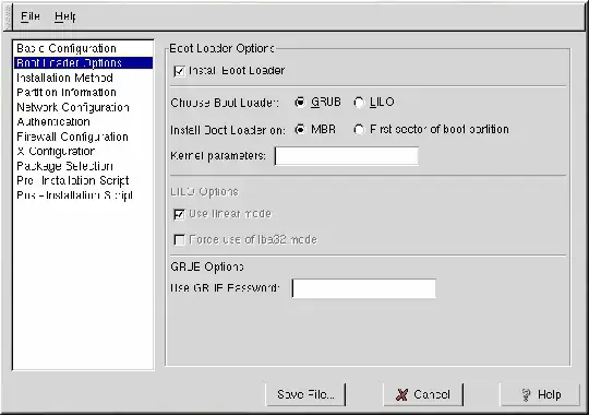

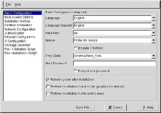

Kickstart (graphically setting up a configuration file)
The Red Hat Kickstart installation method is used primarily (but not exclusively) by the Red Hat Enterprise Linux operating system to automatically perform unattended operating system installation and configuration.
Documentation on preseeding/kickstart for Ubuntu. Ubuntu has limited support for kickstart (and preseeding); one of the missing things is a graphical interface for preseeding. Kickstart does have options for this (see the images) but these do not seem to work on Ubuntu. You can do this manually though (see Preseeding below).
Installation and starting kickstart:
sudo apt-get install system-config-kickstart
ksconfig

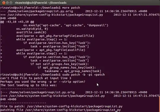

** WARNING **
kickstart is bugged in Ubuntu 13.10 and when starting it, it errors out. Here is a fix. Put the patch in the comment into a text file, save it (I named it "patch") and commit it:

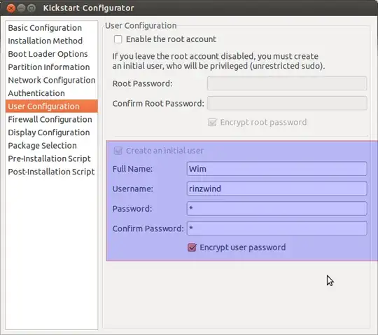

After that ksconfig worked and it will start a configuration editor that allows for you to manipulate a lot of options.
See the Red Hat Linux 7.2: The Official Red Hat Linux Customization Guide for a description for all of the options you can set.

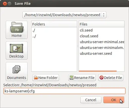

After you are done, save the changes to a ks.cfg file and copy it over to the ISO we are changing:
sudo cp ks.cfg ~/Downloads/newIso/preseed/ks-custom.cfg
  • If you change anything here the installer will SKIP asking for that information if it is considered valid. If you did not change an option the installer will still ask for you to answer.
  • You can also download kickstart files and save those in as ks-custom.cfg in ~/Downloads/newIso/preseed/.
Example where I inserted my credentials. I started it with sudo ksconfig from commandline.
And saving it to the project:

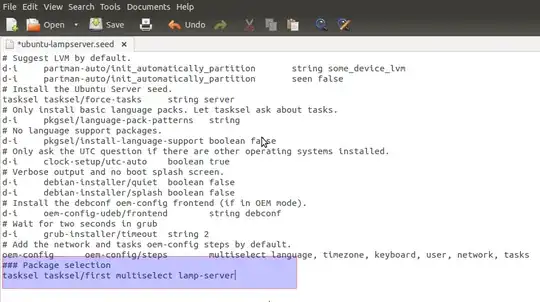

Now for changing settings. Using debconf-get-selections from the debconf-utils you can investigate what parameters you can use with specific software.
Example setting this up:
And adding lamp-server to be installed with tasksel:
  • If you want to add packages "openssh" and "build-essential" you can include this in the seed file:
    d-i pkgsel/include string openssh-server build-essential

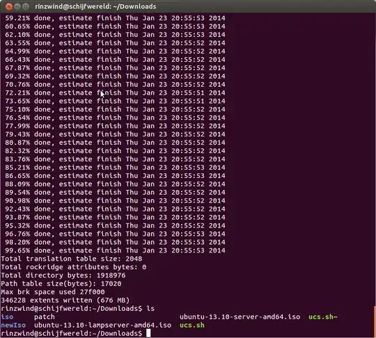

Create the ISO
cd ~/Downloads/
sudo md5sum `find ! -name “md5sum.txt” ! -path “./isolinux/*” -follow -type f` > md5sum.txt
sudo mkisofs -J -l -b isolinux/isolinux.bin -no-emul-boot -boot-load-size 4 -boot-info-table -z -iso-level 4 -c isolinux/isolinux.cat -o ./ubuntu-13.10-myowninstall-amd64.iso -joliet-long newIso/
  • the 2nd line creates a new checksum and is only needed when adding packages.
  • the 3rd makes an ISO from your project that you can burn to a DVD.

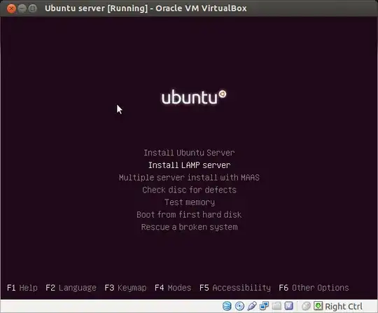

Result:
And now you can try the it out by actually burning and installing it. I would advise to use as virtual machine since it will be quicker for testing the initial created ISO (otherwise you keep rebooting).
And after installing VirtualBox I get the following menu:
