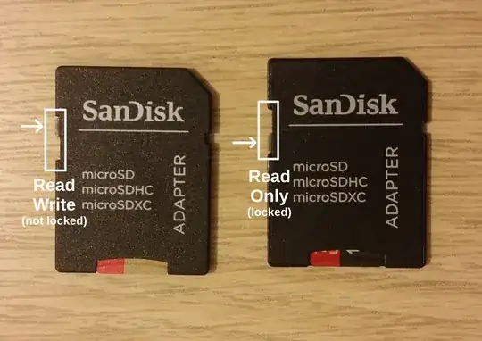

My problem is always that the little lock switch on the side of the SD card is moved to "lock". Yes, I mean the physical switch on the side of the SD card.
See this picture:
SD card labeled lock states
