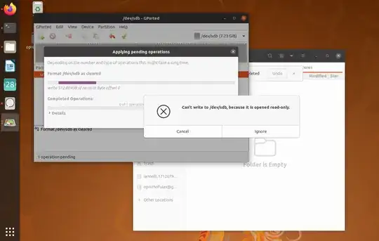

I read many many similar questions on the web, as how to format readonly iso9660 USB drive, USB Disk stuck in read only after dd an ISO, Unable to open /dev/sdb read-write (Read-only file system), but none of them provided answer/solution to my problem. I tried with gparted where I cannot delete partition, since the command is grayed out, and when trying to format I get again the message "Read-Only..."

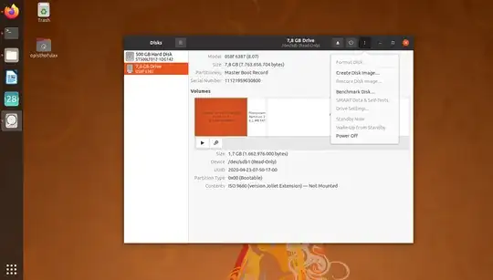

gparted
and got no more luck from Disks

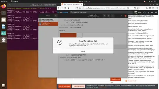

EDIT @Matigo solution:
Following kind @Matigo's solution leads to the following error in my case

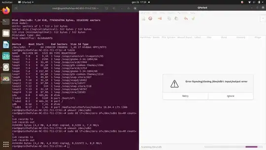

EDIT @Stormlord solution:
Even following these steps I find trouble since Xubuntu is still there. I executed the following code as su -
:~# lsblk
NAME   MAJ:MIN RM   SIZE RO TYPE MOUNTPOINT
loop0    7:0    0   9,1M  1 loop /snap/canonical-livepatch/95
loop1    7:1    0   219M  1 loop /snap/gnome-3-34-1804/66
loop2    7:2    0  55,4M  1 loop /snap/core18/1944
loop3    7:3    0  62,1M  1 loop /snap/gtk-common-themes/1506
loop4    7:4    0    55M  1 loop /snap/core18/1754
loop6    7:6    0 217,9M  1 loop /snap/gnome-3-34-1804/60
loop7    7:7    0  64,8M  1 loop /snap/gtk-common-themes/1514
loop9    7:9    0  49,8M  1 loop /snap/snap-store/467
loop10   7:10   0  31,1M  1 loop /snap/snapd/10492
loop11   7:11   0  97,9M  1 loop /snap/core/10577
loop12   7:12   0    51M  1 loop /snap/snap-store/518
loop13   7:13   0  31,1M  1 loop /snap/snapd/10707
loop14   7:14   0  97,9M  1 loop /snap/core/10583
sda      8:0    0 465,8G  0 disk
├─sda1   8:1    0   512M  0 part /boot/efi
└─sda2   8:2    0 465,3G  0 part /
sdb      8:16   1   7,2G  0 disk
└─sdb1   8:17   1   1,4G  0 part /media/opisthofulax/Xubuntu 18.04.4 LTS i386
:~# umount /dev/sdb1
:~# sudo dd if=/dev/zero of=/dev/sdb1 bs=4M count=1
1+0 records in
1+0 records out
4194304 bytes (4,2 MB, 4,0 MiB) copied, 0,5299 s, 7,9 MB/s
1+0 records in
1+0 records out
4194304 bytes (4,2 MB, 4,0 MiB) copied, 0,522972 s, 8,0 MB/s
and then went on gparted, but with no results

When a storage device is locked in read-only mode, it's usually because something appeared as a hardware failure. Going read-only reduces the risk that more damage will be done before important data can be recovered. That said, unless you're using an older Samsung or Kingston USB memory stick (where this was usually the case), the read-only is probably a false-positive.
Let's try to unlock the drive:
  1. Open Terminal (if not already open)
  2. Type:
    sudo hdparm -r0 /dev/sdb
    This should unlock the device, allowing it to be written to. Now let's go over to Disks.
In Disks:
  1. Select the device you want to format (/dev/sdb in this case)
  2. Press Ctrl+F to bring up the "Format" dialog
  3. Click "Format"
After the format is complete your device will appear as completely unallocated space. Now you can create a partition by pressing on the [+] button and formatting it however you please.
Hope this resolves the problem.
The following steps should solve the problem.
  1. Make sure the USB stick is not mounted.
  2. Open a terminal and type: sudo dd if=/dev/zero of=/dev/sdX bs=4M count=1. Replace X with the actual drive letter. Make sure it's the correct one because if it's not, you'll erase another drive irrevocably.
  3. You should have a completely empty USB stick after this operation. Run gparted and create a new mbr/ms-dos or gpt disk using the Device menu.
  4. Create the partitions you need on the USB stick.
