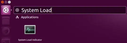

Then start it manually the first time by searching for "system load indicator" in the dashboard.

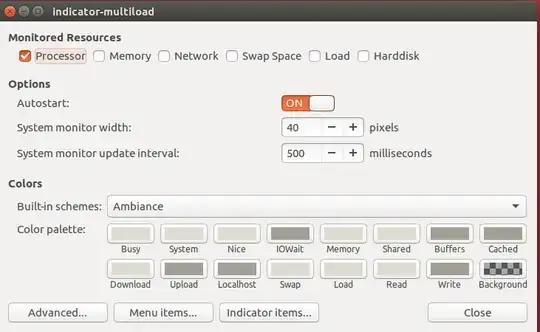

Right click the indicator for preferences.

  1. Search for System Load Indicator in dash and launch it.enter image description here
  2. Right click on the indicator applet and choose Preferences. enter image description here

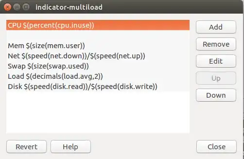

  3. A window will pop up. Click on the Indicator Items... button on the lower middle portion of the window. enter image description here
  4. Move the item CPU $(percent(cpu,inuse)) to the top of the list. enter image description here
  5. Close all opened windows and notice the numerical CPU load displayed in the panel. enter image description here
  6. Note that the entry is customizable. You can get creative and start mixing up different entries. For example, if you want to display memory usage as well, replace the entry with CPU $(percent(cpu.inuse)) Mem $(size(mem.user)), which will result in: enter image description here
