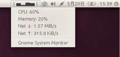

Exactly like old gnome indicator: http://www.webupd8.org/2011/05/network-memory-and-cpu-usage-indicator.html#more
Note from the link: Once installed, launch System Load Indicator from Dash. Unlike the old gnome applets, this is how to add those indicators to the panel.

You can download and install a software package (.deb) from
https://launchpad.net/indicator-sysmonitor/+download here. Once installed you will find it under Applications > Accessories > Sysyem Monitor Indicator and it will look like this in Unity; enter image description here

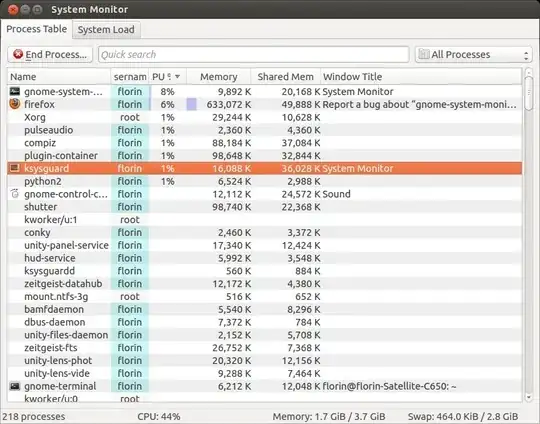

I tried a few applications and I found that the one on KDE is for me the best system monitor tool: ksysguard.
It is in the Ubuntu standard repositories, so you just install it in Software Center.
See the comparison in this screenshot. How much processor Gnome System Monitor uses vs KDE System Monitor (ksysguard)
As you can see, ksysguard is a lot better.
