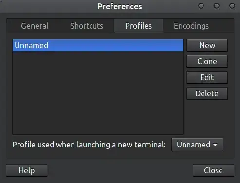

  • Open the terminal, and ignore that you don't have a shell. Go to EditPreferencesProfiles:
  • Either create a new profile, or edit the current profile, to change the command:
    Use either /bin/bash --norc or /bin/bash --rcfile=/etc/skel/.bashrc.
  • Start a new tab (with the custom profile, if you created one). Use the working shell as needed.
  • Delete the custom profile, or uncheck the custom command option if you edited the default profile, once you're done.
