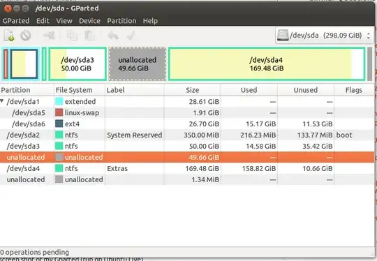

I've Win8/Ubuntu Dual boot. I already have 4 partition so i cannot create a new partition and mount it elsewhere. So, this (How can I increase a partition's size?) question did not help.
Here's a screen shot of my Gparted (run on Ubuntu Live) enter image description here
How can I extend /dev/sda6 so that i can make use of unallocated space ? (w/o failing my current grub)

You have to move the unallocated space just above to the /dev/sda2 so that you can get the unallocated space into the extended partition.
Follow the below steps to increase the size of /root partition and make sure that you had not mounted any partitions,
  • Boot Ubuntu live disk and open gparted partition editor.
  • Now right-click on the /dev/sda3 partition and select Resize/Move option.Now move the dragger to the extreme right so that the unallocated space will comes above the /dev/sda3 partition.
  • Follow the above step to move the unallocated space just above to the /dev/sda2.
  • Now right-click on the extended partition and select the Resize/Move option.Now you can be able to add the unallocated space to the extended partition.
  • After adding that,the space comes just below to the /dev/sda6.
  • Now right-click on the /dev/sda6 partition and select Resize/Move option to add the unallocated space to your /root partition.
