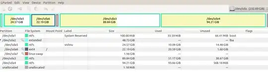

Below is the screenshot of GParted:
GParted showing partitions
What should I do to increase the size of /dev/sda6 without any data loss?

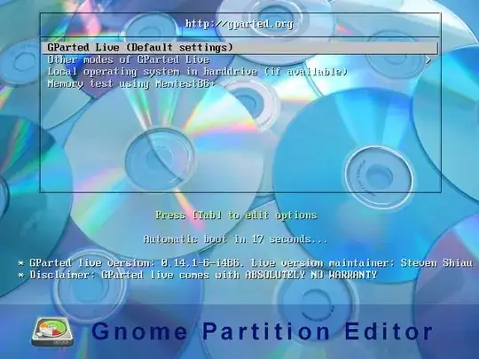

  2. Boot from it. GRUB GParted screen

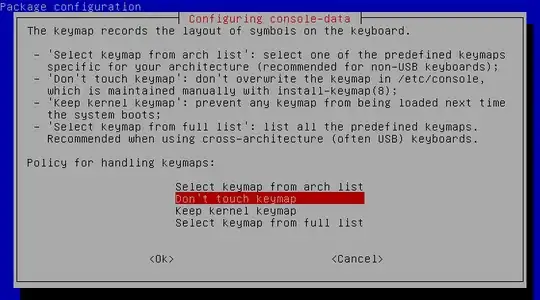

  3. Skip change of keyboard mapping. keymaps handling dialog

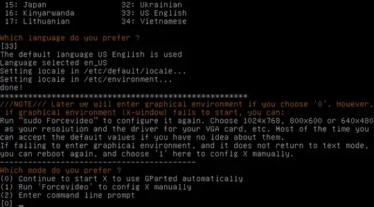

  4. To start up the default graphical environment Press Enter mode selection dialog

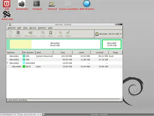

  5. GParted is now running. Running GParted
