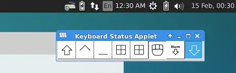

Another solution which is not perfect, but some may find it useful as it is possible to have full functionality as in KDE like activating a mod with a click.
  1. install kbstate applet
    sudo apt-get install plasma-widget-kbstate kde-workspace-bin
  2. Run it in plasma-windowed player
    • Regular window
      plasma-windowed kbstate
      screenshot of plasma-widget-kbstate in Xubuntu
    • Borderless window
      plasma-windowed --noborder kbstate
      screenshot of borderless plasma-widget-kbstate in Unity
I didn't have much time to play with, but wmctrl may help to position, resize and make it on top at launch.
Reference: What command to launch a kde plasmoid and the kickstart menu

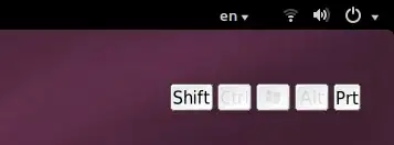

I did a search for Ubuntu sticky keys monitor and found something which may be helpful here: http://code.google.com/p/key-mon/
show case screenshot
Try running
key-mon --sticky for Support for sticky keys.
Reference: http://code.google.com/p/key-mon/
Note that the version available through the software center is 1.6-0ubuntu1. Released June of 2011 which does not support the --sticky switch. If the indicator looks exactly like the above you have the older version Try the latest version at http://code.google.com/p/key-mon/ as of this writing it is keymon_1.17-1_all.deb 229 KB Released Jan 3 2014. Support for --sticky switch tested and confirmed.
