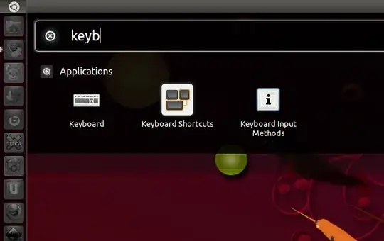

You can then set up the keyboard shortcut by opening Keyboard Shortcuts.
Keyboard Shortcuts in Dash

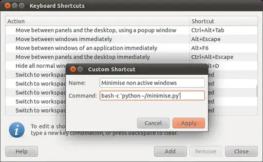

Click on Add to create a new shortcut.
Keyboard Shortcuts window
Use the command bash -c 'python ~/minimise.py' (this is assuming you saved it as minimise.py in your home folder).
create shortcut
You can then assign your preferred keyboard combination to this action.
