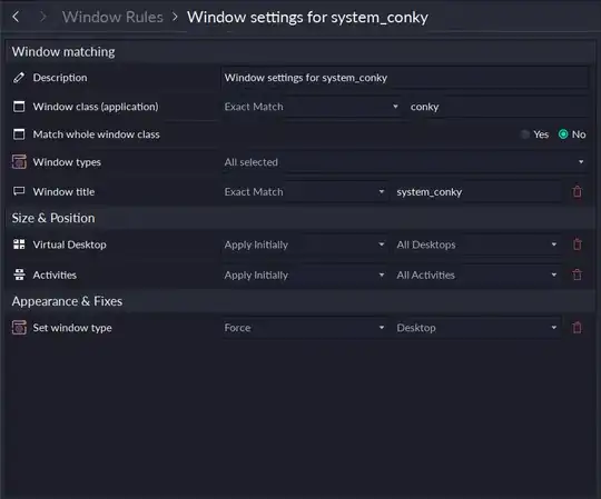

The only way I could get conky to work in Plasma desktop was to use KDE's window rules. (The conky flags shown here were enough to achieve the same effect on XFCE).
own_window = true,                          -- create your own window to draw
own_window_argb_value = 100,                    -- real transparency - composite manager required 0-255
own_window_argb_visual = true,              -- use ARGB - composite manager required
-- own_window_class = 'Conky',              -- Manually set the WM_CLASS name. Defaults to "Conky".
-- own_window_colour = '#ffffff',           -- set colour if own_window_transparent no
own_window_hints = 'below,undecorated,sticky,skip_taskbar,skip_pager',                  -- if own_window true - just hints - own_window_type sets it
own_window_transparent = true,              -- if own_window_argb_visual is true sets background opacity 0%
own_window_title = 'system_conky',          -- Manually set the window name. Defaults to "<hostname> - conky".
own_window_type = 'dock',                   -- if own_window true options are: normal/override/dock/desktop/panel
Finally for KDE, I needed to also declare the following window rule:
